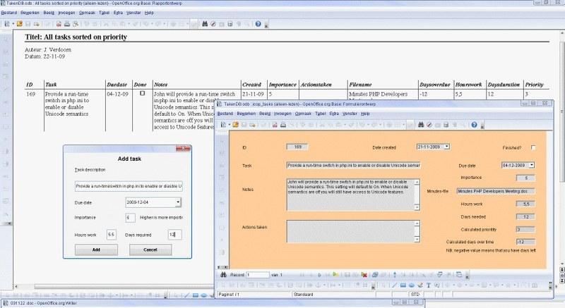

The goal for this extension is to have an easy way during meetings to create tasks in a to-do list and manage them afterwards. It presumes that you make minutes and would like to generate a task list during meetings with ease and manage them.
minutes2tasks 5c99bc94 1d42 4d4a 8578 200c358ae22b
Description
Easy install for Windows and OS X with this new and final version 1.2.2; click and play! The goal for this extension is to have an easy way during meetings to create tasks in a to-do list and manage them afterwards. It presumes that you make minutes and would like to generate a task list during meetings with ease and manage them. When there is a task that has to be done by you, you activate the macro (through a keystroke or by using the menu). A window box comes up, where you can fill in the subject of the task, the due date and some other details. The macro also records in the background the filename if you were making minutes at the moment, the current date and a paragraph selected with text (hopefully related to that action). If no text is selected, no text is recorded. Afterwards you can call a report, from a database called TakenDB.odb, from within Writer. It gives all the unfinished tasks, sorted on priority. That database also contains other useful reports, which you can use if you open the database with Open Office Base. The database also contains a form where you can browse through all the tasks and make changes. I use this extension on a daily basis for my work. It reduces mind-traffic; after a day full of meetings, I know the tasks that I took on during those meeting are well kept on one place, easy accessible. I have also my digital minutes of those meetings, but I don't have to open them again to remember my tasks and their details. Remarks:
